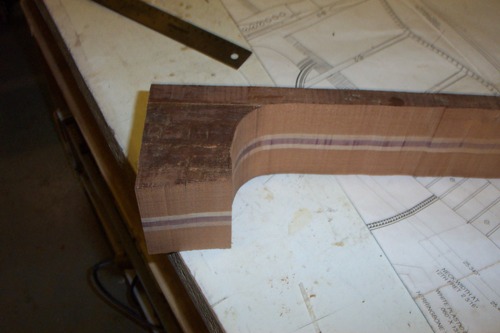

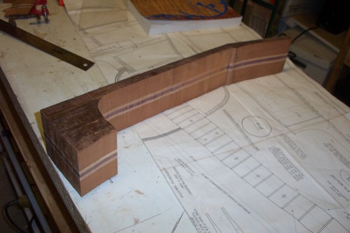

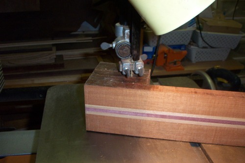

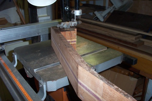

Yep, being on vacation helps a bit, today i made myself a plexiglass template for the neck profile and used it on my neck blank to draw the outline, i then cut the blank on my bandsaw.

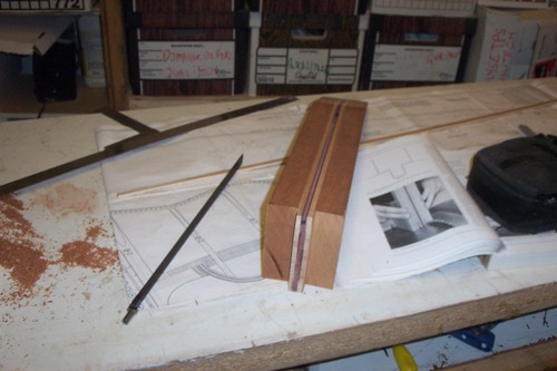

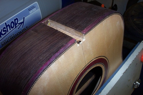

I cut the entry for the tenon on the top.

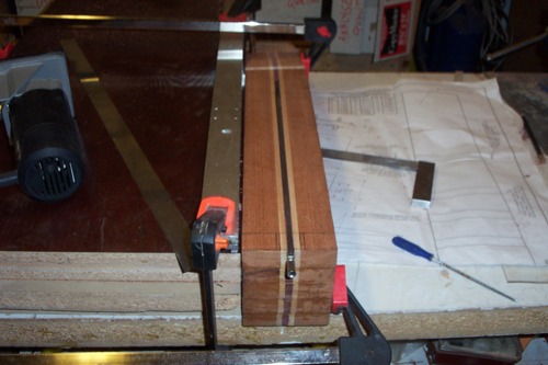

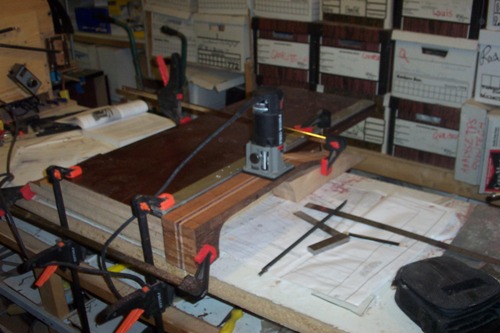

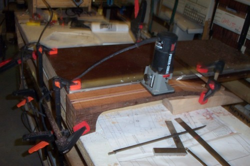

Routed the channel for the truss rod, check the set up made with boards and clamp everywhere, it worked well but i'm sure there is a simpler way of doing that, i'll probably start a thread just to see your setting up
To the left of the neck, there is a thick aluminum straight edge that i used to cut the straight channel, my router was leaning against it.

OT: Are you pretty happy w/ your Ridgid bandsaw so far?

Thanks Jordan, yes, my bandsaw does well for lutherie things, i find it big enough, of course, i'd like bigger but the cash flow is runnin' low around here, i do recommend it to anyone who wishes to buy one though.
